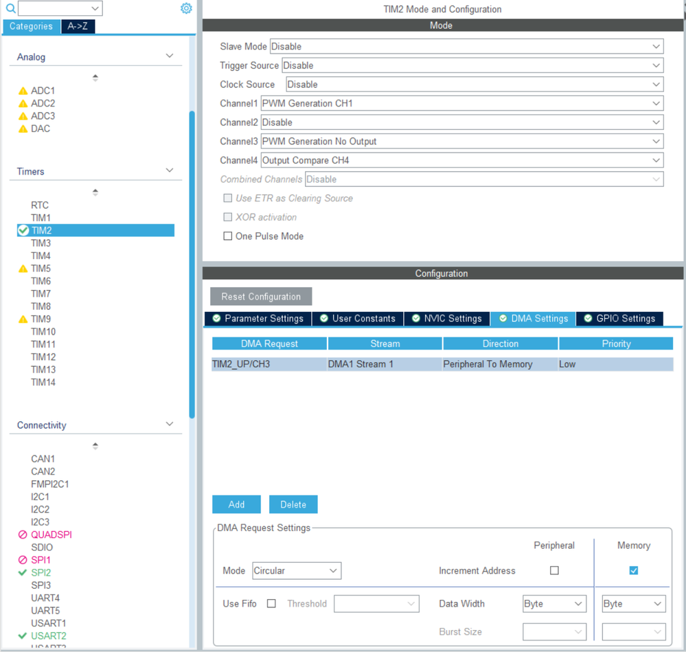

Below is how the DMA is configured for the timer (to receive from SPI):
[In DMA request, I can only select TIM2_UP/CH3, instead of TIM2/CH3 in your screenshot]

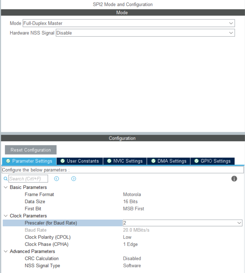

My SPI is configured as below:
The following code:
[I swapped the SPI2->DR and buffer around (line 3-4) since I want to receive, not transmit, I believe this is correct. Am I perhaps not correctly setting a register in the SPI module to initialise it for receiving?]

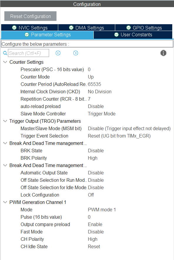

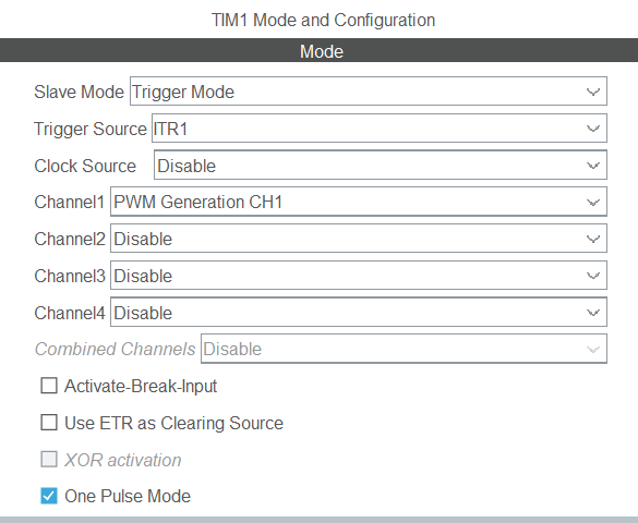

Hi KnarfB, I'm not able to get the one pulse mode working on TIM1. I have tried many settings but can't seem to get anything out.
I have got TIM1 triggering on TIM2 working (when I set TIM1 channel 1 output to something that isn't using the OnePulse mode). From the reference manual, TIM2 can trigger TIM1 using ITR1.
I am using line 1 of the code below to try to start the one pulse functionality on TIM1:
HAL_TIM_OnePulse_Start(&htim1, TIM_CHANNEL_1);
HAL_TIM_PWM_Start(&htim2, TIM_CHANNEL_1);
HAL_TIM_PWM_Start(&htim2, TIM_CHANNEL_3);Below is an example of the type of setup I am trying for TIM1 (I have verified that the trigger mode is working, but also tried one pulse with trigger disabled):Thank you!

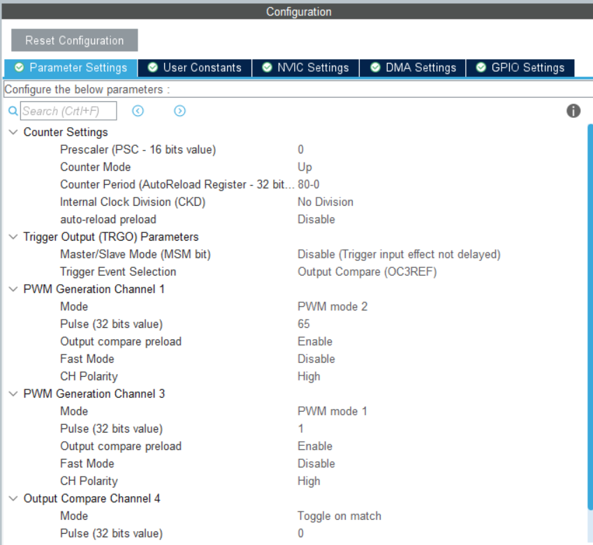

2022-02-22 6:37 AM
Looks promising. For TIM1 Clock Source set Internal Clock. Counter Period to 2 (something small) and CH1 PWM Pulse to 1 (not 0).
TIM2 is as yesterday with TRGO Trigger Event Selection to OC3REF.
In main() just start both timers.
HAL_TIM_PWM_Start(&htim1, TIM_CHANNEL_1);
HAL_TIM_PWM_Start(&htim2, TIM_CHANNEL_3);I get the clock pulses.
