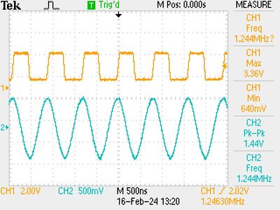

I have built a sine wave to square wave circuit and now want to measure its frequency with the STM. I can see on the oscilloscope that the circuit works, however I can detect neither a rising nor a falling edge with the chip. It is not a problem with the code as I can detect both when they are generated by the chip with PWM or externally with a generator (which is old and its square wave really isn't that square) but also they are much slower.
The frequency of the wave is 1.24MHz, measured with the oscilloscope. I don't think that this is too fast, the timer runs at 96Mhz, but maybe using interrupts at this speed is too much?

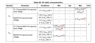

The minimum voltage of the wave is 0.6V. I am suspecting that might be too high to be considered a logical 0 but I can't find documentation.

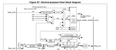

>point me to documentation
See ds and rm from your chip (on STM website )
To count frequency, need to use external clk input for timer .
This from F407 ds , you didnt tell your device.

In its datasheet it says "1.7V<=V_DD<=3.6V". I am correct to then say that my 0.6V should get read as a logical low, right?

You didnt understand, what i tried to say :
you should not use "capture mode" or so, but external clk input + gating the timer for (typical 0,1 ...1 sec);
then you see in counter the counted pulses, in 1 sec gating -> 1,2 mio pulses (only with TIM2 , 32bit possible),
otherwise 16bit counter would overflow.
TIMx_ETR is the input for counting external frequency . So you get max. resolution .

2024-02-16 3:13 PM
