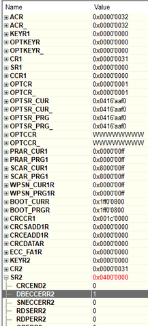

I get a busfault exception when I read bank2 flash memory. I can read bank1 with no issues. From the flash register SR2, it shows as ECC double bit error. This is new pcb and I can flash the hexfile to bank1 successfully.
Even a Jlink memory read showed read error (below SS):
I erased the entire chip using "JFlashLite.exe" and after that it started working normally. Why is this so ? Are we supposed to erase the entire flash for every new MCUs ?

Do a mass erase.
Because the ECC thing can go hairwire. TL;DR. The flash mass erase (aka full chip erase) internally resets the ECC and the flash should behave well until the next disturbance.
What could happen to a new PCB? No idea. May be static electricity, radiation etc., power failure during programming or erase.
