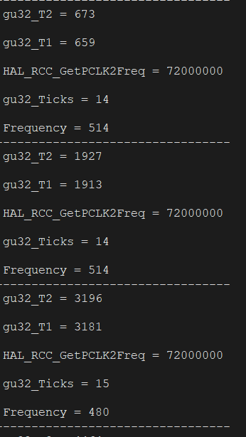

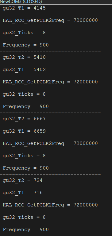

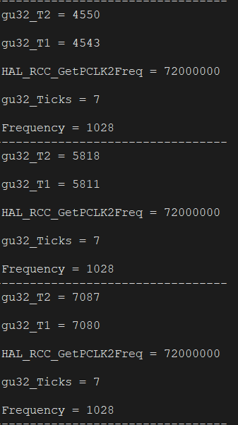

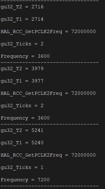

Code is exactly same as above except new print statements are added.
Please refer to the screenshots below.
Thanks.
Image 1 : Arduino frequency : 900 , stm32 captured frequency 900
Image 2 : Arduino frequency : 1000 , stm32 captured frequency 1028
Image 3 : Arduino frequency : 500 , stm32 captured frequency 514/480
Image 4 : Arduino frequency : 5000 , stm32 captured frequency 3600/7200

It's clear now. You have too little discernment. For values of gu32_Ticks 7,8,9 the calculated output frequency is 1028, 900, 800. There is nothing in between. (You cant get value 1000, because all values are integral.)
