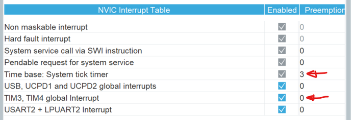

Both TIM3 (10 ms time base) and TIM4 (OC toggle mode) have a higher NVIC priority than Systick, which is used for periodic, unrelated checks. See the below screenshot.
Please advise. Thank you!

Try clearing the interrupt flag is cleared. This can be done using __HAL_TIM_CLEAR_IT(htim, TIM_IT_UPDATE); the issue could potentially be caused by NVIC priorities!
