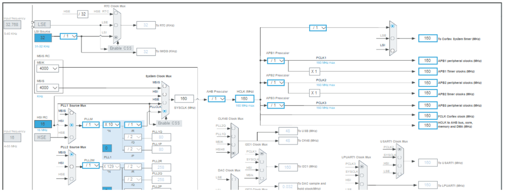

Here is my clock configuration running at 160MHz.

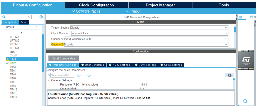

Secondly, my timer 1 as PWM1 Generation.

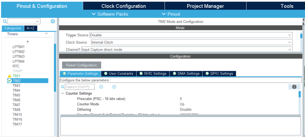

Them, Timer 2 as Input capture direct mode for rising edge

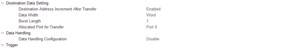

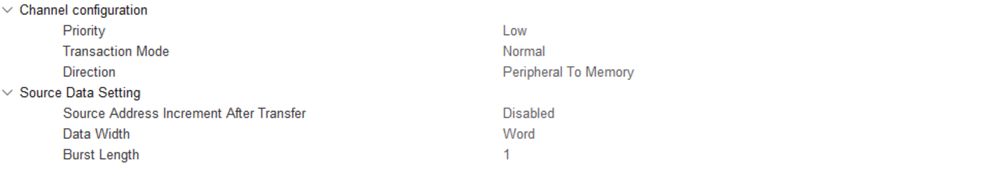

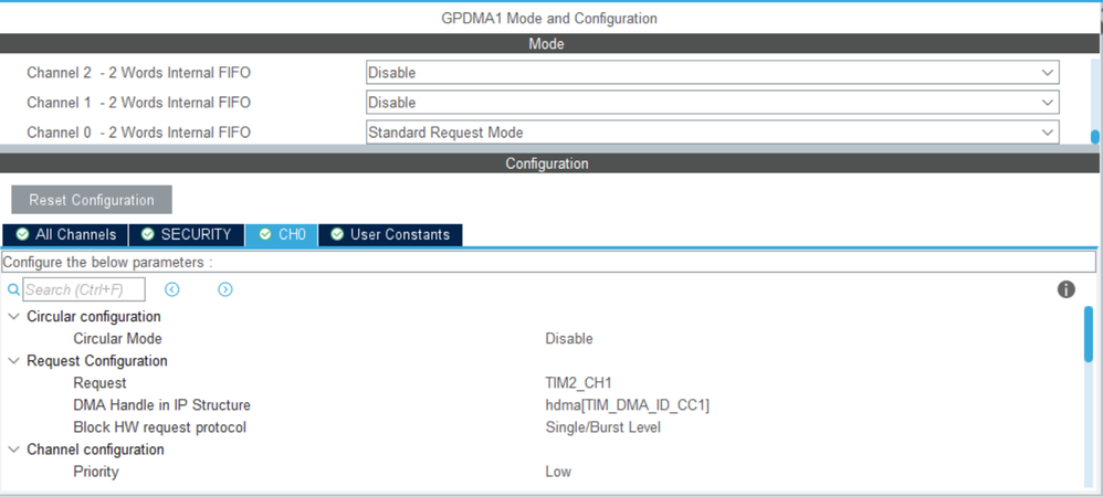

And GPDMA1 as follows, I tried as much as I understand from the tutorial because in the tutorial they could setup the DMA in respective Timer setup.

#Issure 1 : Finally I do get output, for case of 160MHz clock and Prescaler of 160 and ARR of 10, I am supposed to get 10KHz (160MHz/Prescaler/ARR) , but i do get frequency measurements of 40KHz , which has been consistent with the change of prescaler and ARR. i.e., 400KHz instead of 100KHz. ( Sometime its 396KHz , although it could be because HSI input)
Note that, I checked the PWM output generation by Timer 1 , it really produces what it is supposed produce for example 10KHz or 100KHz, i have tested the PWM frequency by another microcontroller. so it is really the issue of detecting the frequency of timer 1 input capture.
#Issure 2 : Another issue is the code is not running the while loop more than once as it is supposed to be, turns out the code in while loops just runs once because of isMeasured status doen't change from 0 to 1. As, I have no idea why is it not updating.
/* Call the measurement whenever needed */
if (isMeasured)
TIM2->CNT = 0;
HAL_TIM_IC_Start_DMA(&htim2, TIM_CHANNEL_1, riseData, numval);
isMeasured = 0;
Here is output of the loop it only prints once :
