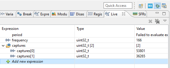

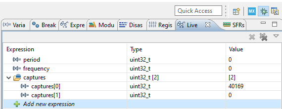

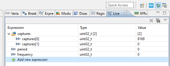

What I mean by getting no readings is shown in the following images.

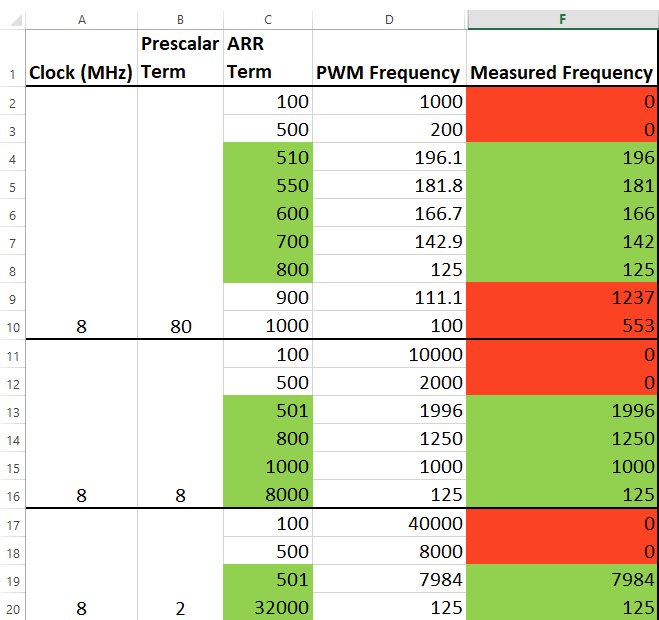

So I'm using a different timer on the board to output a PWM signal for my input capture pin to pick up. So if I set that timer to a prescalar value of 80-1, and an ARR value of 100-1, this should output a PWM signal with frequency 1000Hz, well above my minimum frequency. However, I pick up no values:
It looks like it captured one rising edge, but nothing after that.
Similarly, if I adjust the PWM signal to a prescalar of 80-1, and an ARR value of 500-1, that will output a frequency of 200Hz, still above the min frequency. However, I still pick up no values:
However, if I change the ARR value to be 600-1, while keeping the prescalar at 80-1, which is a PWM value of 166Hz then it actually does give me the correct frequency.
And it turns out this works as intended only for a small range between ARR values of 501 to 800, but everything else below 501 doesn't capture.
So here's where I get confused...if I change the prescalar from 80 to 8, then I can actually capture a frequency of 1000Hz correctly, but I'm still limited to a range between ARR values of 501 and 8000 this time. I made a table comparing all these different values.
Am I missing something here about how the STM32 is producing PWM signals? Does it have a limit on ARR values? My guess is that it actually does, and the limit is 500.
So if I turn up the clock speed, I bet this will work with higher PWM frequencies.
So then that begs another question, why is there this ARR limit?

2020-03-19 12:39 PM
The prescaler is 16 bits, so 65536 is not a valid value.
If it's 65535, then your timer tick rate is 8MHz / 65536 = 122Hz. So you can't capture anything faster than this. If you're trying to capture 1kHz signals, you'll want a much lower prescaler.
ARR has a 16-bit limit. It does not have a limit of 500.
I would suggest looking over the input capture section of the reference manual for a better understanding rather than changing ARR values and hoping for the best. Not the interaction between timer clock, prescaler, and auto-reload value.
Based on the code in your OP, you almost certainly want ARR = 65535.
