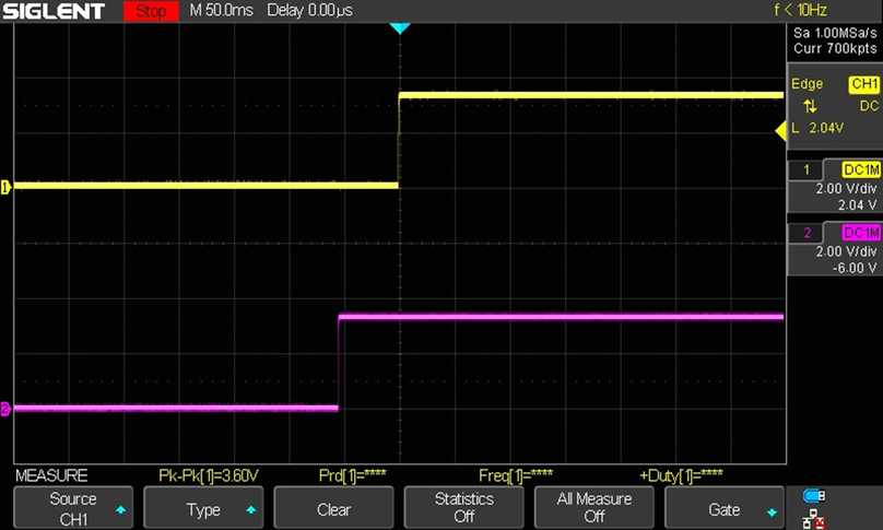

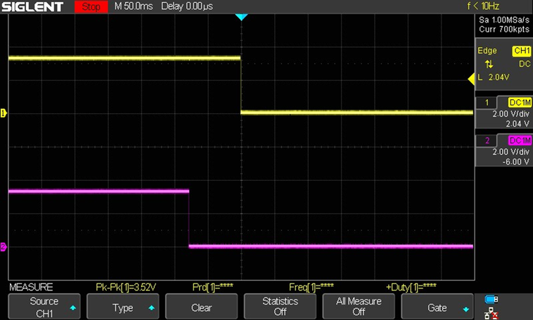

Following is a bit more info on what is happening:
You can see below on the oscilloscope the capture of the two signals where Encoder_A is on CH1 and Encoder_B is on CH2.
When Encoder_B signal goes low first the two counters are not the same. I believe this happens because the polarity of the Encoder_B on the firmware is set to rising but the signal goes low instead therefore missing 1 count within the interrupt. In the while loop the counter is updates correctly though.
On the other hand, when Encoder goes high first the two counters (in the interrupt and while loop)are the same:
The same behaviour occurs on the opposite direction.

Right. So, you have two edges per counter tick.
Input Capture events normally (i.e. I expect that it does) triggers on a switch in logic level, not when the counter changes value. So, if a pin toggles, but (due to polarity, turn direction, whatever) this edge is not what triggers the change to the counter value, when you read the counter value in the callback, it hasn't yet seen the other edge. When the other edge occurs, the counter updates, but there's no callback, because the 2nd edge does not trigger an Input Capture event. Does that make sense?
