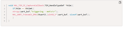

void HAL_TIM_IC_CaptureCallback(TIM_HandleTypeDef *htim){
if(htim == &htim4){
strcpy(uart_buf,"triggering - meh\n\r");
HAL_UART_Transmit_DMA(&huart3,(uint8_t*)uart_buf, sizeof(uart_buf));
}edit: It seem the Interrupts were triggering, but due to large number of interrupts, the MCU was not able to execute anything. What i want to achieve is that i want to initiate SPI in DMA mode after it overflows (update event), will enabling DMA for timer help?

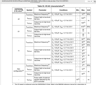

I could only find this in the datasheet
What about the timer input capture, is it same like GPIO EXT Interrupt.
I even applied a 1MHz signal still not working, but for 100KHz it is working, but i need it to work for fast signals.

> edit: I tried the timer input capture too, but still same effect, I used the HAL_TIM_IC_CaptureCallback , ...
Don't you see the problem here ?
Are you not aware that "callbacks" are executed in interrupt context ?
2025-11-06 3:44 AM - edited 2025-11-06 3:45 AM
I don't get it , what is the problem ? i'm still learning :)
2025-11-06 4:20 AM
While you running in interrupt context, especially of the very same interrupt, other one's will be blocked.
Which can especially disastrous when when calling other time-consuming functions that in turn rely on interrupts.
I don't know this HAL UART functions work (I'm not a Cube/HAL user). But either interrupts or busy-wait until the transmission finished.
I don't know what you want to achieve here in your code example, probably only an indication that the EXTI interrupt was triggered.
Better set a flag or increment a counter, which you can access/evaluate from the main loop. That would suffice as a proof of concept. If it works once, it usually works always.
You always need to consider and check your MCU's time budget.
