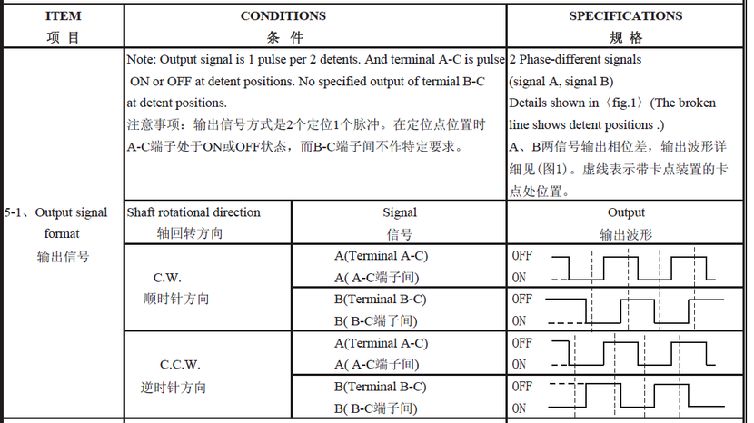

Following is a part of the encoder datasheet.
Thank you.

The reason the HAL_TIM_IC_CaptureCallback is fired every second turn is because the nature of the incremental encoder I have. The A & B signals go low every second turn and both IC1Polarity and IC2Polarity was set to TIM_ICPOLARITY_FALLING.
I have changed the sConfig.IC2Polarity from TIM_ICPOLARITY_FALLING to TIM_ICPOLARITY_RISING and now the HAL_TIM_IC_CaptureCallback is fired on each turn of the incremental encoder.

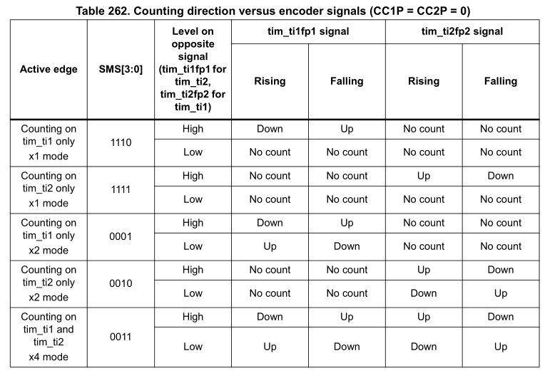

Did you try playing with the polarities for each channel? The reference manual has all the details, you should go through it.
This is from G4 RM but should apply
In the RM, this table is followed by two waveform diagrams, you should look at those.
2024-07-01 4:28 AM - edited 2024-07-01 4:35 AM
You can change direction with setting polarity of *one* of the signals, i.e. setting one of the TIMx_CCER.CCxP bits.
I don't understand why would you want to have interrupts upon every edge; I don't think it's possible and I don't quite understand why would changing polarity change that. [EDIT] Re-reading your initial post, I now see you want one interrupt per *detent* - that might be possible if there are several (2 or 4) steps per *detent* and it may then depend on selected polarity. What I wrote about direction of counting above holds. You also can always reverse direction of rotation in software, simply by subtracting current TIMx_CNT value from (TIMx_ARR + 1). [/EDIT]

When I set the two signal polarities to TIM_ICPOLARITY_FALLING the HAL_TIM_IC_CaptureCallback triggers every second turn. The direction is correct though.
Changing the direction of just one of the signals causes the HAL_TIM_IC_CaptureCallback to triggere on every turn however the direction is the opposite o want it to be.
I am using 0011 setting on SMS[3:0]
