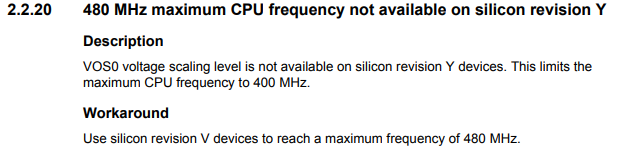

depending on the Revision of the Chip the Maximum frequency might be only 400MHZ, as you can read in the Errata (ES0392) of the Chip under 2.2.20

If you have MCU with revision Y it is mean that maximum frequency is 400 MHz. I achived 420MHz, but it isn't stable.
So be carefull and do checking the revision register at any time you want to configure CPU clock.
ERRATA:
