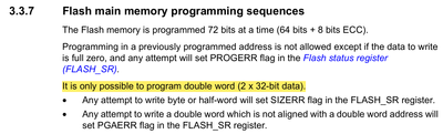

for(uint32_t x=0;x<1024;x+=2){
// uint32_t word = ((uint32_t)BackBuffer[x+1]<<16)|(uint32_t)BackBuffer[x];
*(volatile uint32_t *)(addr) = BackBuffer[x];
while(FLASH->SR & FLASH_SR_BSY);
FLASH->SR |= FLASH_SR_EOP;
addr += 2;
HAL_GPIO_WritePin(GPIOA,GPIO_PIN_5, GPIO_PIN_SET); //LED on if playing
}You're writing 4 bytes (uint32_t), then you're skipping ahead only 2 bytes and writing again. This is not allowed. You must write exactly 2 uint32_t to an aligned address. This is also not writing every value. Your commented code is better but needs to skip ahead 4 bytes, not 2.
