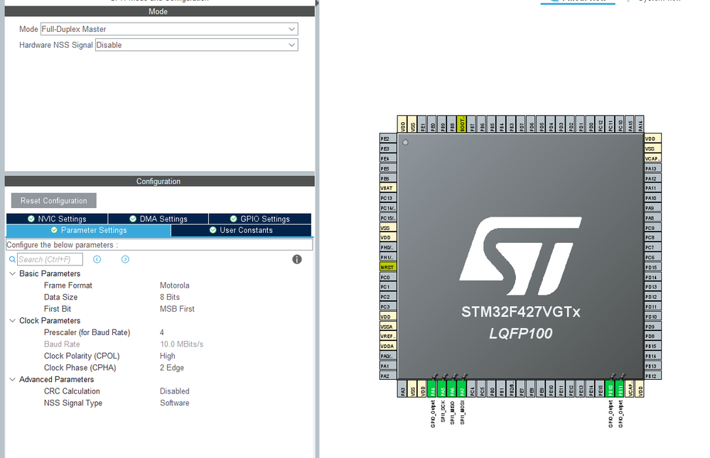

I tried all the possible settings CPOL (HIGH and LOW) , CPHA ( 1 edge and 2 edge) , slower baud and nothing, I read some posts other people had problem too with SPI but apparently made it working only with I2C

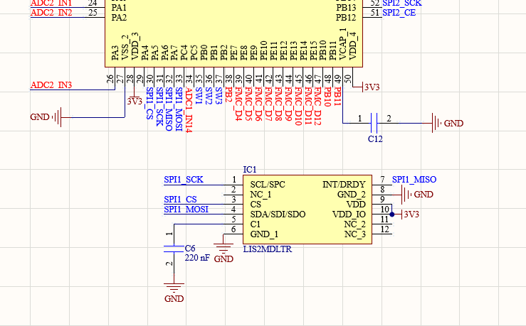

I even tried to solder another LIS2MDLTR and another, nothing!

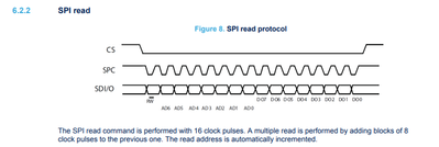

I think your SPI setting is wrong, its half-duplex-master spi :
+ dont drive it at max speed for beginning...try 2 Mbit or so;

2025-08-23 2:16 PM
thanks that was the problem and it works now
tested with 10 Mbit/s
I switch to
CPOL = LOW and CPHA = 1 EDGE
when it powers up it works with 3 SPI after that it can be switched to 4-wire (full-duplex).
