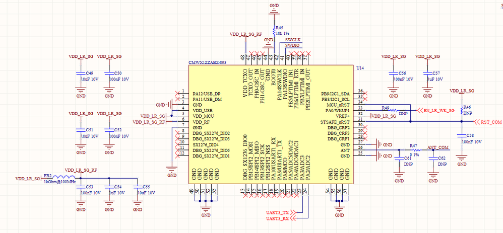

I design a LoRa aplication with CMWX1ZZABZ module. The schematic which I use is the following:
And the current consumption es 1.2mA. Anybody know which are the errors in the schematic to get 1.65uA of the datasheet of the module.

Is this question related to STM32?

Our application consists of a micro stm32f103 that communicates
with lora module and we assumed that the module automatically enters into low power but the consumption of the module remains at 1.2mAWe’re moving the ST Community to a new platform to give you a better and more reliable community experience.
