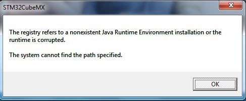

2018-06-13 2:19 AM
I have installed STM32CubeMx IDE Tool, i am getting error while i run the tool ,Please let me know how to resolve this

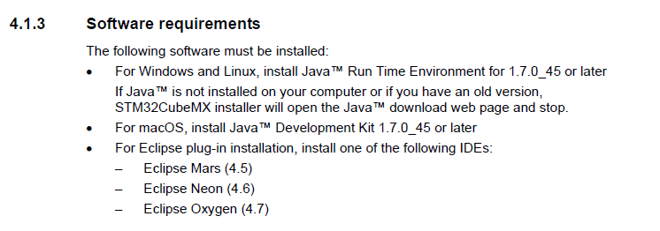

,It seems that you have problem with java version which can not be compatible with your CubeMX version. Please can you specify this two information (java and CubeMX version).
As an information, the help document of CubeMX precises the minimal java version that can work with. Here is an example for CubeMX 4.

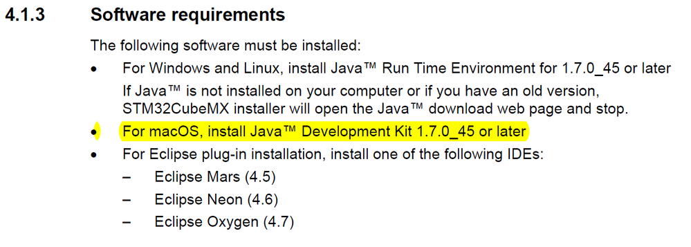

2018-06-20 6:48 AM
Hi
nitesh.padiyar
,As mentioned in the picture below extract of CubeMX help, for macOS, you should install Java Development Kit JDK and not JRE (Run time Environment) to run CubeMX correctly.
Hoping it helps you, please do not hesitate to contact me for further details.

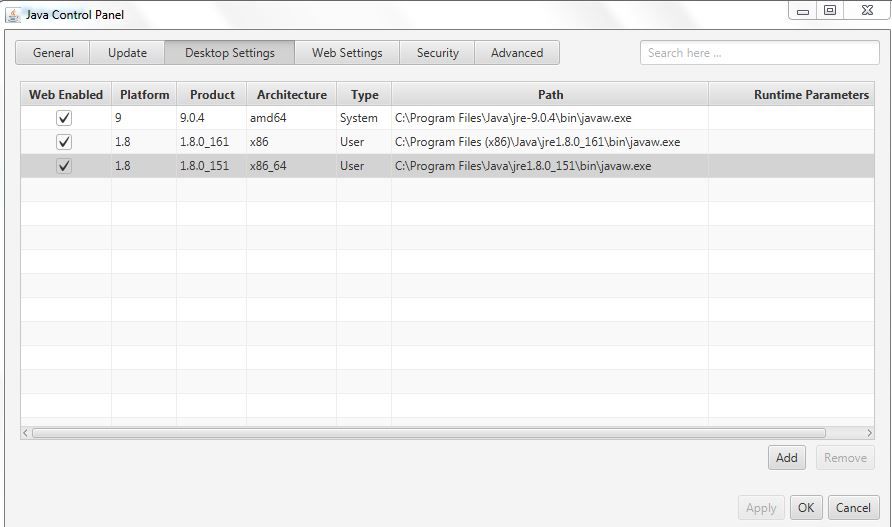

2018-06-21 5:02 AM
Unfortunately, I'm not able to reproduce your issue. CubeMX runs properly with 1.8.0 java version. Can you please try to select just 1.8.0_151 java version and disabled the two others versions installed in your laptop.

2018-06-21 8:23 AM
Perhaps it has an issue with finding JRE 9.0, or there is some old junk still in the registry.
I just have JRE 1.8.0.151 installed (not multiple) and the Java Control Panel looks different. That runs CubeMX without problems.
