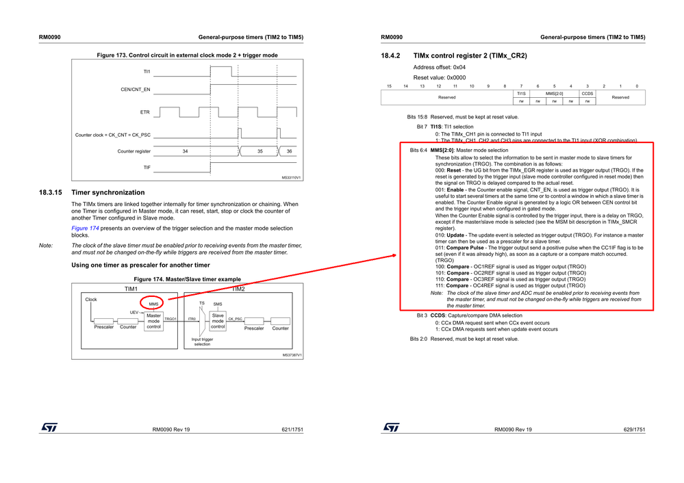

sMasterConfig.MasterOutputTrigger = TIM_TRGO_OC4REF;
But it was originally set to TIM_TRGO_UPDATE, but no difference in functioning.

The main thing the slaveModeSyncrhonization is write the SMCR register SMS field. The description of the "Using one time as prescaler for another timer" specifically states one must write two values to SMS field, i.e., they seem to be commands, not simply configuration bits. Perhaps I should only write the second SMS by simply writing updating the SMS field in the second write.
