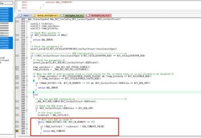

I am currently using STM32G0B1. I found that when using an active crystal oscillator, the STM32 fails to recognize my crystal oscillator, resulting in the HSERDY bit not being set.
This is the configuration of my cubemx.
Use an oscilloscope to check if the crystal oscillator has started oscillating.

The crystal oscillator has started oscillating normally, but the clock initialization will enter a waiting state for the timeout of HSERDY. Could this be a reasonable phenomenon?
