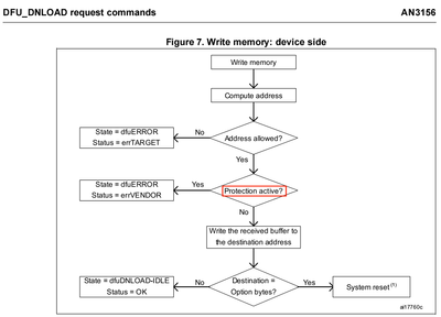

Elmue
Associate III
STM does not always comply with the DFU specification and creates their own procedures.
STM states that they do not use DfuStatus_ErrWrite as usual if memory cannot be written.
Instead they use their own error code.
As you can easily see here even the official ST documentation states that in case that a protected memory cannot be written the processor should return error Status = ErrVendor and State = dfuError.
But it does not.
So this is DEFINITELY a HUGE BUG !
