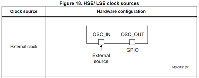

We are using MEMS OScillator for the clock source for STM32G474 MCU. And are unsure if we can use the OSC_OUT pin as a GPIO pin when using the MCU in Clock Source BYPASS mode.
The datasheet mentions we can, I, however, would like to confirm once if this pin needs to be left unconnected, grounded or can be used as GPIO without any issues.

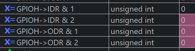

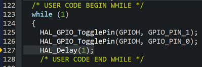

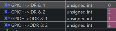

It works on the H7 just as the RM says it will. Clock is in bypass mode. PH0 and PH1 are both initialized as GPIO output and toggled, only PH1 responds to the toggle. Verified with a scope but also reflected in IDR. Bypass mode configuration takes precedence over gpio config, so GPIO functions on PH0 have no effect.

You can use OSC_OUT as a GPIO when clock is used in BYPASS mode. This varies by family, but it works here.

2023-07-28 9:52 AM
