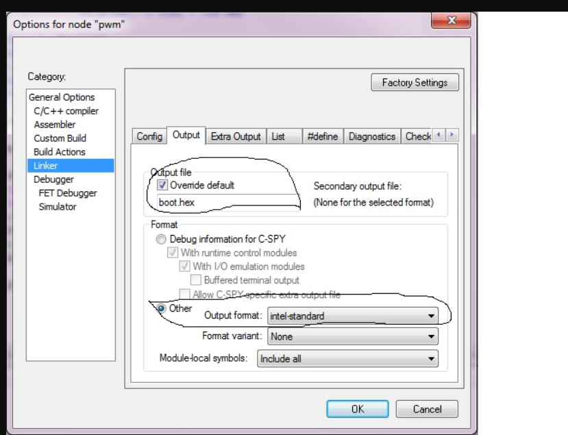

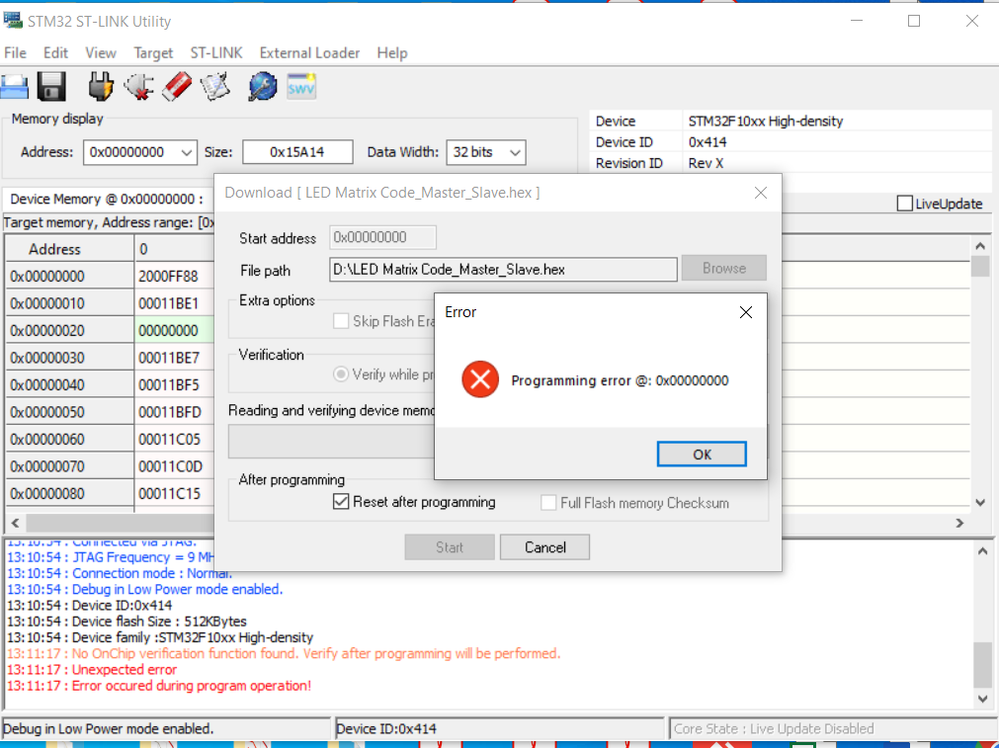

I have generated intel binary file using iar 6.2 version for stm32f103vet6 but while flashing the same error occurs
what can be issue for programming error@0x00000000

That you're build code to reside at 0x00000000 and not 0x08000000 ?
Check your Linker Script or .ICF settings, check the .MAP to see what the Linker is building, dump the .ELF to see what was generated there, or load the .HEX in a text editor an check that. Should have one of the first couple of lines indicate the right memory segment/offset to start with.

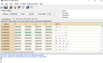

linker script .icf below
/*###ICF### Section handled by ICF editor, don't touch! ****/
/*-Editor annotation file-*/
/* IcfEditorFile="$TOOLKIT_DIR$\config\ide\IcfEditor\a_v1_0.xml" */
/*-Specials-*/
define symbol __ICFEDIT_intvec_start__ = 0x08000000;
/*-Memory Regions-*/
define symbol __ICFEDIT_region_ROM_start__ = 0x08000000 ;
define symbol __ICFEDIT_region_ROM_end__ = 0x0807FFFF;
define symbol __ICFEDIT_region_RAM_start__ = 0x20000000;
define symbol __ICFEDIT_region_RAM_end__ = 0x2000FFFF;
/*-Sizes-*/
define symbol __ICFEDIT_size_cstack__ = 0x400;
define symbol __ICFEDIT_size_heap__ = 0x200;
/**** End of ICF editor section. ###ICF###*/
define memory mem with size = 4G;
define region ROM_region = mem:[from __ICFEDIT_region_ROM_start__ to __ICFEDIT_region_ROM_end__];
define region RAM_region = mem:[from __ICFEDIT_region_RAM_start__ to __ICFEDIT_region_RAM_end__];
define block CSTACK with alignment = 8, size = __ICFEDIT_size_cstack__ { };
define block HEAP with alignment = 8, size = __ICFEDIT_size_heap__ { };
initialize by copy { readwrite };
do not initialize { section .noinit };
place at address mem:__ICFEDIT_intvec_start__ { readonly section .intvec };
place in ROM_region { readonly }hex file initials;
place in RAM_region { readwrite,
block CSTACK, block HEAP };
initial address 0x00000000 in hex file 2000FE28 000294FD 00020781
