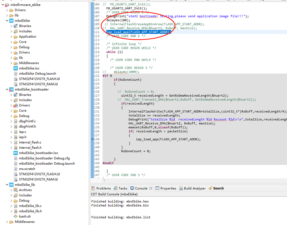

the atteched file mbxfirmware_ebike is our solution code . we have three projects .and I am doing the bootloader testing .
the mbxEbike is my application project ,and I set
#define VECT_TAB_OFFSET 0x8000 /*!< Vector Table base offset field.
in this application project
and I debug this project in STM32cubeIDE, It works well.
the mbxEbike_bootloader is my loader project .
first I write the application bin file to 0x08008000 by ST-LINK Utility and then I debug the loader project in STM32cubeIDE, the loader project starts up OK ,but the function
iap_load_app(FLASH_APP_START_ADDR);
fail to jump to application code
I can not find out why fail to jupm to application code .
please help me to look into the code
2020-12-10 11:47 PM
already fix this issue . I use systick as timebase in bootloader ,but in my application what I use as a timebase is timer1 so before I jump to application I need to disable systick,
If NOT , after jumping to application , system will go to hardfault
