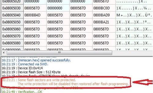

Dear All,
Please have a look. I have write protected area from 0x08000000 - 0x08004000 after boot loader flashing. Now I flashes my application at 0x08005000(atarting address for my application, 0x080040000 - 0x08005000 (2KB)left blank intentionally ) using ST Link V2. Dont know why ST Link V2 removes the write protection (as shown in image below).We’re moving the ST Community to a new platform to give you a better and more reliable community experience.
