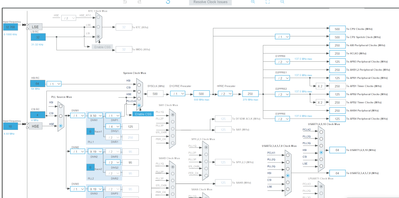

The MCU core seems to be running at 500MHz and the timers at 250MHz.
That's 2 nano second and 4 nano second clock period respectively.

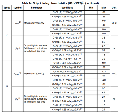

Gyessine
Hello @JinJin
If  I understood your question right
based on your product Datasheet table 54
if you choose "VERY HIGH" as GPIO maximum output speed you can reach toggling times of nano seconds, but you will need a very clean implementation
Hope that answered your question
Gyessine

I have already completed the code implementation using the EXTI → Timer → GPIO HIGH flow.
With the prescaler configuration shown in the attached clock configuration image, I am able to achieve a nominal delay resolution of approximately 4 ns.
However, I suspect that the latency introduced by the EXTI interrupt and the timer interrupt is not constant on each occurrence. As a result, the GPIO rising edge timing varies within a range of approximately 500 ns.
Therefore, my main question is whether there is any method to minimize this jitter within the STM32 MCU architecture, or if this behavior is an inherent limitation of STM32 when using an interrupt-based approach.
Any clarification on whether this level of jitter can be reduced further, or if a different hardware-based approach is required, would be appreciated
