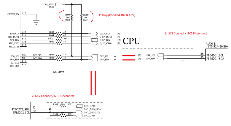

I2C1 uses PF 0, 1 / I2C2 uses PB 6, 7. The HW PCB completed, and the HW I2C pull up is the same.

2025-01-22 2:16 AM - edited 2025-01-22 2:17 AM
@Jdogk wrote:The HW PCB completed, and the HW I2C pull up is the same.
Please show the PCB schematic.

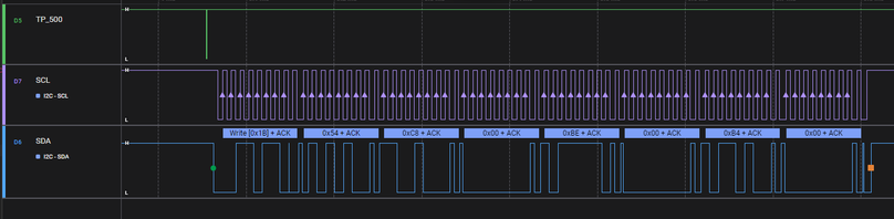

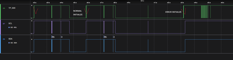

here is logic analyzer sequence
Above one is normal intialzie and normal I2C communication sequence
I Think I2C1 is not working in abnormal initialize

Main issue is I2C1 go to HAL BUSY Flag.. and system locked.
I2C Master Transmit in to HAL BUSY Flag
I think Not initialize to HAL_I2C_STATE_READY
This situation is often seen when you turn it on after first connecting the power, and it's working well afterwards.
