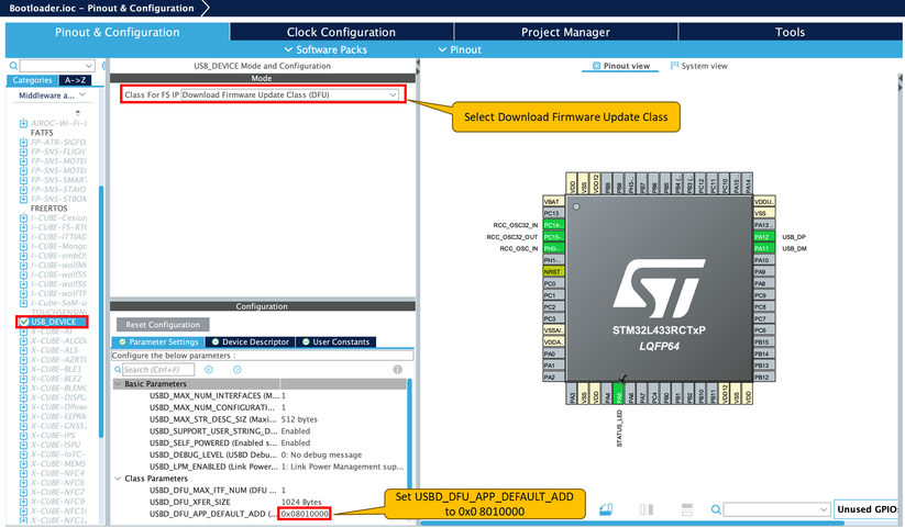

The implementation is shown below.
Bootloader USB configuration...

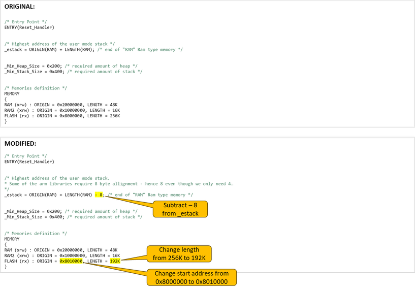

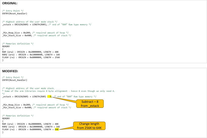

Changes to bootloader linker script...

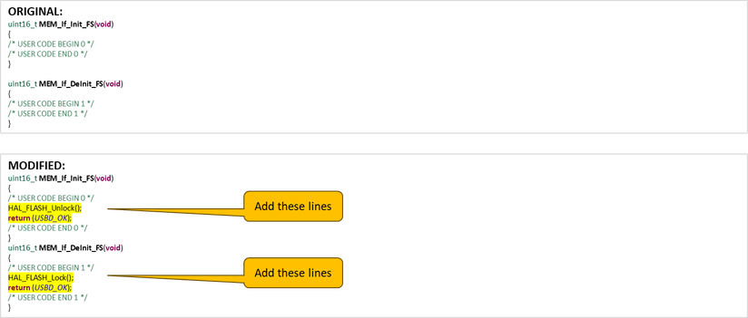

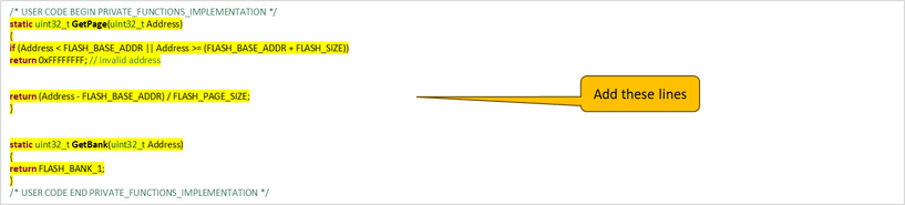

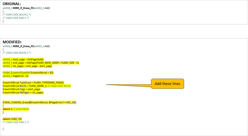

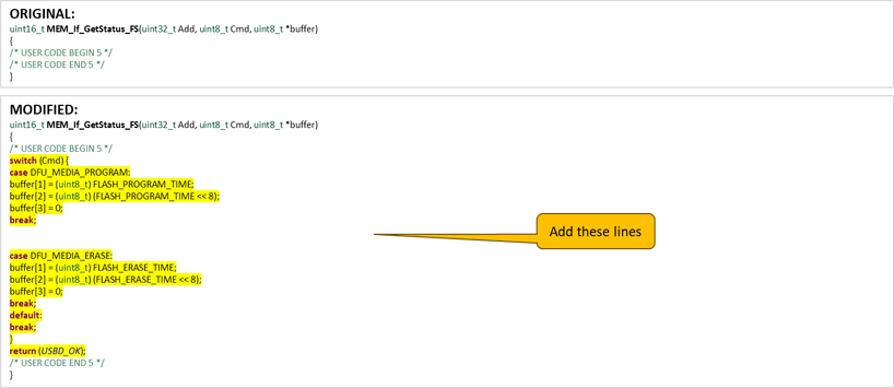

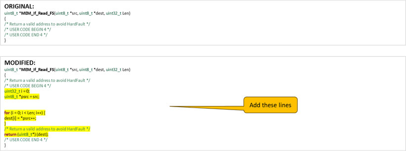

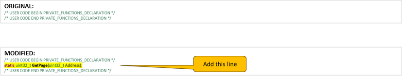

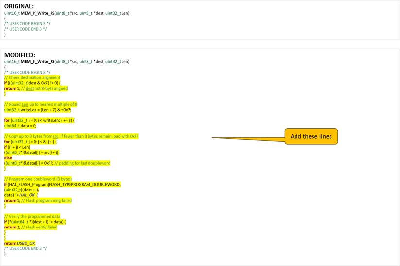

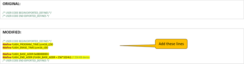

Changes to bootloader usbd_dfu_if.c....

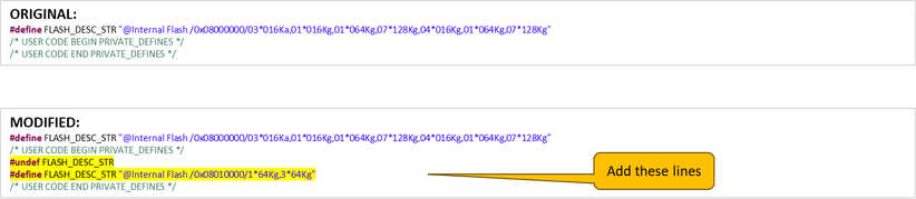

Changes to bootloader usbd_dfu_if.h....
Changes to application linker script...

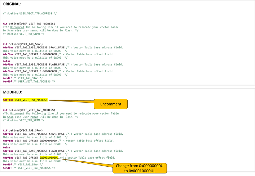

Changes to application system_stm32l4xx.c...

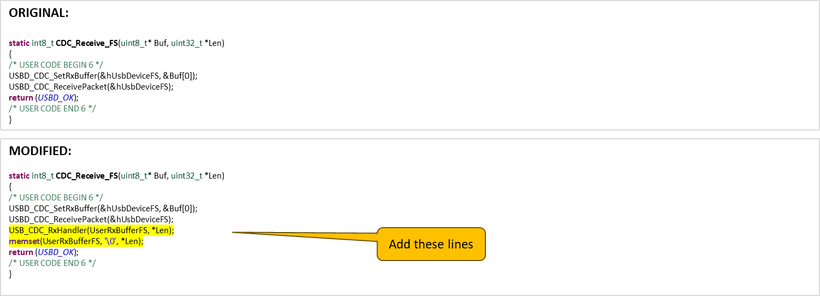

Changes to application usbd_cdc_if.c...

Does your bootloader relocate the VTOR after the jump?
If you do not modify the startup_stm32xxxx_init.c file or, as I always do, place SCB->VTOR = to the address of the app in memory, any try of using interrupts would fail!
I see you indeed modify the startup file but for sake I would also add the SCB->VTOR = xxx before the call to HAL_Init just to be super sure.

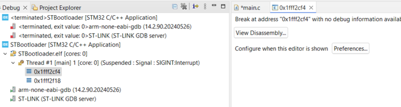

However, when the bootloader is called the computer does not see the USB DFU device.
If I pause the debugger, it shows the following...
My code is below...
