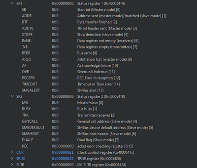

No, here are the registers AFTER the start bit wasn't generated:
But that's after the timeout, isn't it. If there was some error/status flag, it would have been already cleared by the error interrupt, wouldn't it.

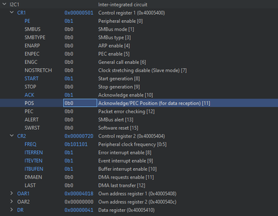

OAR1 = 0x4018 is interesting. Since it's a master, why is this register modified? The highest bit set is in a "reserved" section of the register. Not sure if it's relevant.

OAR1 is modified because it has a random slave address I set on CubeMX
