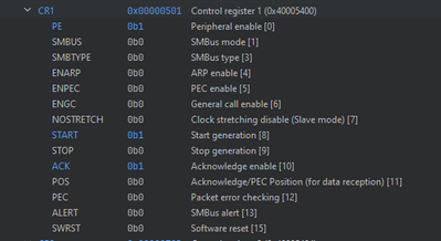

1. After sending a couple of messages(always 4 at most) over I2C I get no start condition when setting CR1->START, if I pause the program a couple of seconds later and I inspect the register it is still at 1 and never goes back to 0.

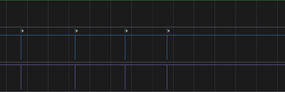

1. I did use a logic analyzer and start condition is in fact not generated (line stays at logic 1)

Show a screenshot of the I2C registers when the error occurs. Probably missing something in there. Note that BUSY can cause this behavior.

As we can see, the state switched to TWI_SENDING, which should mean start condition was sent but as we can see on the logic analizer, fifth start condition is never sent.

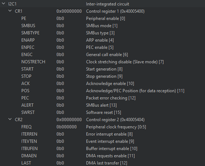

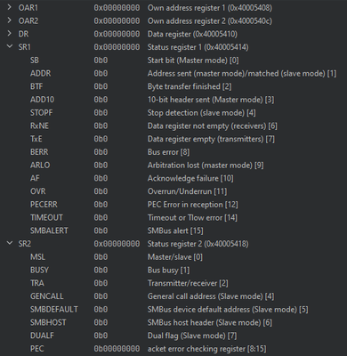

Here are the registers:
2024-12-30 6:55 PM - edited 2024-12-30 6:58 PM
Your register output shows all 0s in the I2C1 registers. The peripheral is not even enabled, it's certainly not going to send a start condition.

2024-12-30 7:06 PM
I know that, I didn't notice PE was 0, but I can ensure that I don't set it to 0 manually, I have no clue how is it turning to 0. I am also not using pointers directly in this program.
2024-12-30 11:56 PM
You do that in resetTWI() --> LL_I2C_EnableReset(), indirectly, by setting SWRST.
After that, you would need to reinitialize the whole I2C machine.
However, the primary problem is that you call resetTWI() at all, so you should investigate there.
