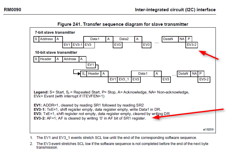

In the datasheet I found the following:
So I added use the following source code in case a STOP interrupt is given (just a code snippet):

// STM32 was in mode receiver => clear AF (userguide page 845 - EV3-2)
hi2c2.Instance->SR1 &= ~I2C_FLAG_AF;
}But without success, the AF is set once again. :(

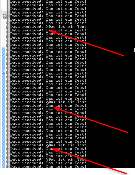

Furthermore from times to times (for now I ignore the error) I get the following:
The 1/2 is in hexadecimal 0xAB. I assigned 0x55 as slave address. With the one Bit bitshift (7bit address) this is 0xAA and with the read bit set, this is 0xAB. It seems to me the STM32 is sending the first byte (address + RW bit) back to the master.
