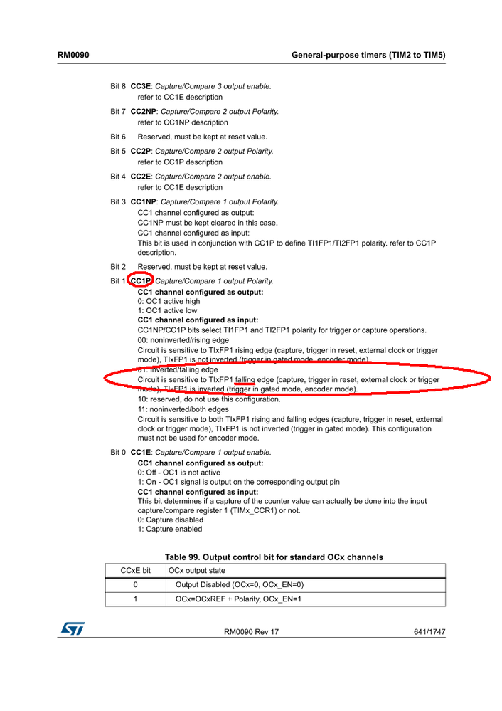

> TIM1->CCER |= TIM_CCER_CC1P | TIM_CCER_CC1E; // rising edge
No.
2019-01-15 11:33 PM
Thanks for your support . The program worked fine when changing the trigger edge of external clock pulse .
