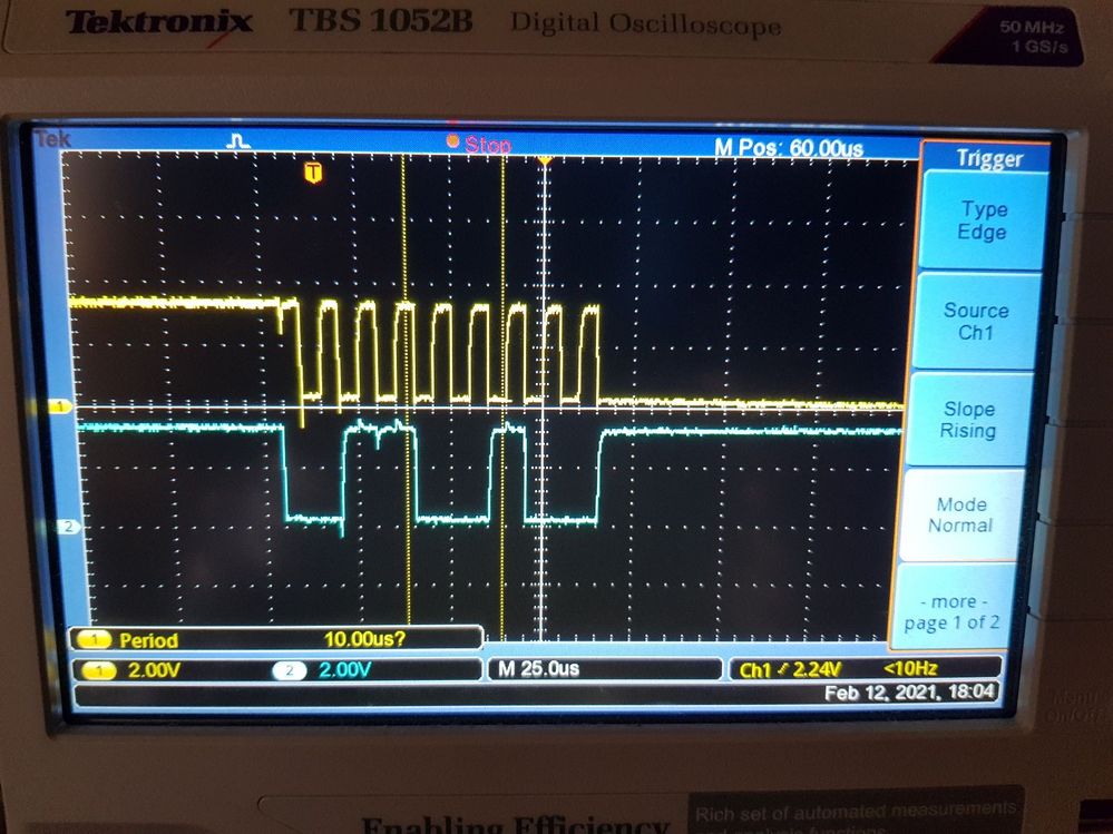

I have the problem that I get an endless slave Clockstretching.
STM32F072 I2C configured with CubeMX, Primary slave adress $32
If I fire a Tx frame from a master with for example:
HAL_I2C_Master_Transmit(&hi2c1, 0x64, buf, 1, HAL_MAX_DELAY);
The clock is hold down by the slave and never released. The address matches, for the I2C ISR register I can see the reception address and the Busy and ADDR register set.
If I send for example:
HAL_I2C_Master_Transmit(&hi2c1, 0x66, buf, 1, HAL_MAX_DELAY);
I can see that the 9th clock comes and there is no acknowledge.
Activation of "Clock No Stretch Mode" solves my problem but I want to use the slave strech mode AND I do not understand why the slave does not ACK the frame and leaves the clock.
2021-02-12 6:07 AM
Hmm i mean Master control clock line, when you have checked that Slave hold it down, its crazy strange.
