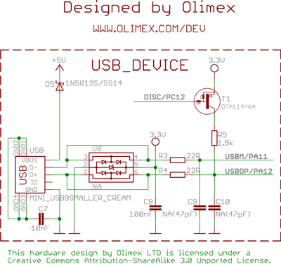

Series resistors on D+ / D-
Could the missing 22Ohm resistors be the root cause?
Does ST recommend these in general for STM32L4 designs (see e.g. USB tutorial on mikrocontroller.net)?
ESD protection (USBLC6-2SC6)
Could this component disturb the USB lines under certain conditions?

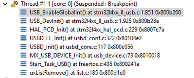

I have noticed that the issue occurs when setting the interrupt register in the USB_EnableGlobalInt() function. Specifically, the system hangs at the following line:
USBx->CNTR |= (uint16_t)winterruptmask;In the function:
HAL_StatusTypeDef USB_EnableGlobalInt(USB_TypeDef *USBx)
uint32_t winterruptmask;
/* Set winterruptmask variable */
winterruptmask = USB_CNTR_CTRM | USB_CNTR_WKUPM |
USB_CNTR_SUSPM | USB_CNTR_ERRM |
USB_CNTR_SOFM | USB_CNTR_ESOFM |
USB_CNTR_RESETM | USB_CNTR_L1REQM;
/* Set interrupt mask */
return HAL_OK;
}Below is the call sequence for this issue:
Has anyone experienced a similar issue or has any idea why setting the interrupt mask could cause the system to hang? Are there any known problems with accessing the CNTR register or timing issues during USB stack initialization?

I performed a test where I removed the USB protection circuitry and connected D+ and D– directly to the USB-C connector. Interestingly, the firmware still occasionally hangs during startup in this configuration.
However, when I plug a USB-C cable into the connector, the firmware starts reliably without any issues.
Question:
What could be causing this behavior?
Is it possible that the presence of the cable influences the line termination or voltage levels in a way that stabilizes the USB stack initialization? Could this be related to pull-up/pull-down behavior, impedance matching, or floating lines when no cable is present?
Any insights or similar experiences would be greatly appreciated.
