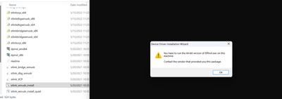

I am having trouble installing a Batch file from the STSW-LINK009 Software ZIP file.
I am on a Macbook Pro M2, running Parallels Windows 11.
When I try to download the "stlink_winusb_install" batch file I get a pop-up saying that I need to use the 64-bit version of the "DPlnst.exe" on my machine.
An installation Wizard should start running but I get that pop-up instead. I will provide a screenshot of what I see.
I don't understand what that means and don't know what my next step should be. Any help would be greatly appreciated. Thank You!
2024-09-03 8:38 AM
Go into the dpinst_amd64 (64-bit) directory rather than the dpinst_x86 (32-bit) one
