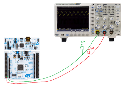

I've got a problem because I tried to check the SDA and SCL pins like in the picture :
Sorry for the paint picture (the oscilloscope was during classes so I don't have it right now).
The output was all the time noises even thought the code was correct.

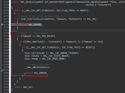

I've had this error :
I don't know if this Timeout is because the I2C didn't receive the ACK bit ?

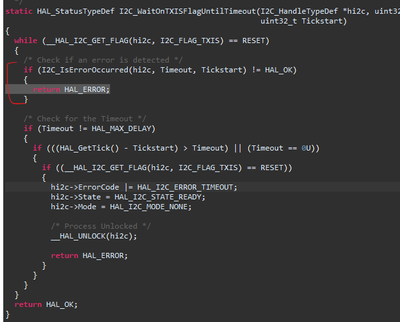

But when I've added the pull up resistors :
The error was then this part :
I don't really much know what happened though.

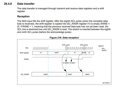

In RM for STM32 Nucleo-L073RZ I found this :
I don't know if I2C_RXDR is the ACK bit that Master is now an input and waits for this ACK/I2C_RXDR ? Maybe but this stretch was maybe a timeout ?
I got a bit confused. Is master receiving more data through SDA (or maybe SLC although it is only a clock), not just only Start, Stop, ACK and data ?
Also the Transmission is different because it stretches the clock after ACK and Receiver before ACK, weird, somebody knows why ?

2023-11-22 11:51 AM
Paint pictures is ok , but is GND scope and board connected ? Is pullups value ??? Is to nucleo 3,3V usw...
2023-11-22 12:01 PM
Ahh yes you are right. The GND is indeed connected just forgot to add it on the picture.
The resistors 3.3V is taken from the board.
I just wondered why I didn't have a normal output but sinusoidal noises.
And why adding resistor changes the error in function. The Transmitter from STM is the Output so the floating output shouldn't be a problem because it depends of the input, the floating input can be a problem.
