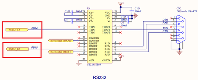

Why you need to do that? by setting up JP7 and JP8 to 1 and 2 connects RS232_Tx and RS232_Rx respectively to PB14 and PB15. From the board schematic:
PB14 and PB15. Did you wire something on the board?

Sorry but why are you using PA9 and PA10 here?
You should configure PB14 and PB15 to use DB9 for USART1 as indicated in the schematic:
