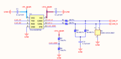

Also what is the bitrate you are using for CAN communication? are you sure you set the same CAN bitrate?
Could you please also your schematics? especially CAN part STM32/Tranceiver.

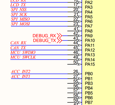

We require a bitrate of 500,000 bps. To achieve this, I selected the appropriate prescaler, BS1, and BS2 parameters.
Here is the schematics:
In the transceiver, we grounded the STB pin.
