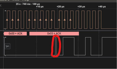

I have facing an I2C timed-out error on the host side while communicating with the MCU I2C continuously.

2024-01-23 6:52 AM
Looks like your logic analyzer and your signal are out of sync. Perhaps show from the start of the signal. This looks very much like an ACK pulse:
The solution to recover from a stuck SCL is the following:

2024-01-31 6:51 AM
Looks like the slave and master get descynchronzed. This could be due to a code bug (most likely) or a glitch on the line. If you save enough data on the logic analyzer you could pinpoint where this happens exactly. If it's always in the same spot, probably a code bug.
There are some oddities in the I2C peripheral as well. It is probably not a silicon issue, but that is also a possibility. Consult the errata sheet for your chip.
