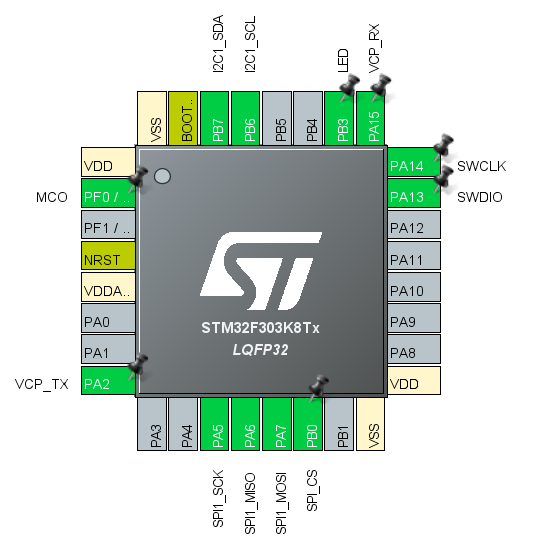

My code including EITHER I2C or SPI works successfully on STM32F303K8T6 Nucleo Board. However, with my code including BOTH I2C and SPI , Only SPI functions work correctly ,but I2Cs don't.
Using a ocsiloscope, It was found that voltage levels of I2C pins don't fluctuate at all when SPI initialization code exists. Is it impossible to use I2C and SPI function at the same time?

Are you using both SPI and I2C on same pins?
CubeMX doesn't support dynamic HW reconfiguration. It has to be done by coding.

No, I2C and SPI are assigned to different pins, but there seems to be something wrong with initialization.
