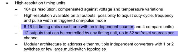

I have not done this, but from my reading of the docs on the (specialized) HRTIM peripheral, it can do this (in P/N which have it):
I would call this more "advanced", while the OP is a self-proclaimed newbie (welcome!). Or was, 4 years ago. Still, I think ST does have support for this use case, Please correct me if I'm wrong, I could be misunderstanding the docs.
