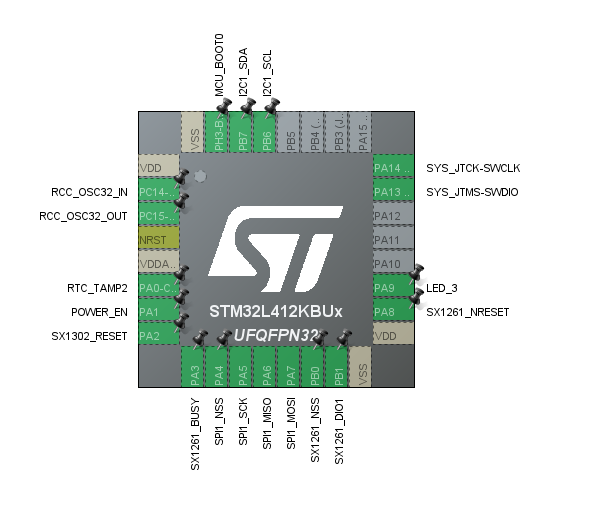

It is the STM32L412KB, I think I only have the PA0 available

> What does that mean? Is it necessarily connected to PA0, cannot be it connected elsewhere?
That is something I was wondering too. I am following a reference design and it uses the PA0 as an input pin which is connected to the output clock of the radio module. I assumed that it might be utilizing the PA0 as RCC_CK_IN to synchronize clocks? so I guess that it has to be that pin and not a normal GPIO but I am not sure.
