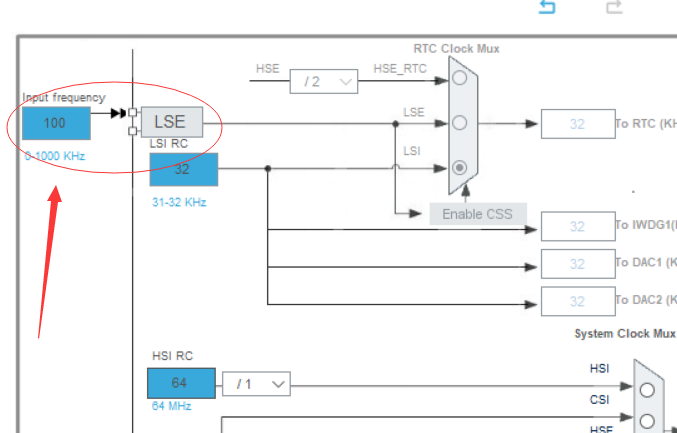

100khz Oscillator for LSE input. The OSCillator works right bcz I test the waveform by scope.
but stm32h7b0vb cannot get lserdy bit set.
Seems I m the 1st Person meet the situation.
plz help me. Thanks.

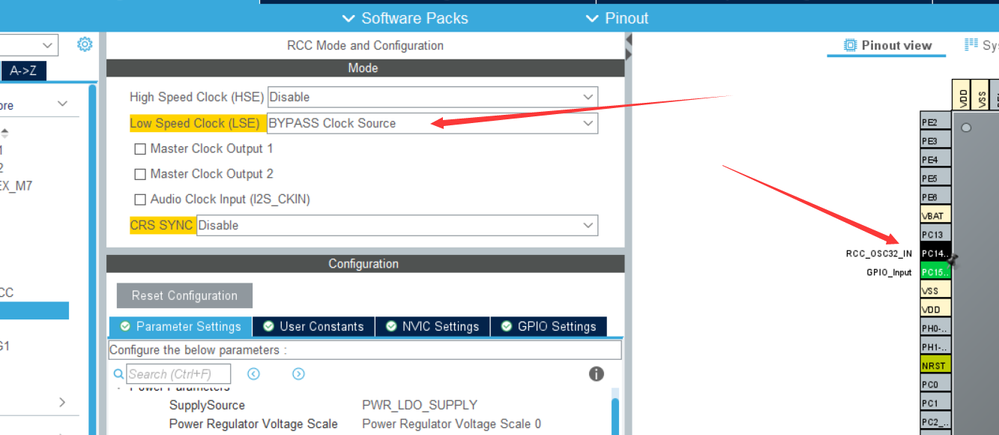

it is sure Oscillator , Not crystal. I set the bypass
I guess it is bcz ST not test LSE by freq other than 32768hz.
I also try call the function LL_RCC_LSE_SelectDigitalClock() but no effect

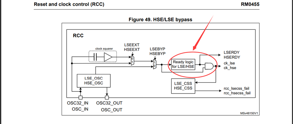

but things are not that simple. Look at the pic below. I will explain it.
the "ready logic" module inside the red circle is very important, bcz follow it there is an "AND" gate, while the "ready logic" or "LSERDY Bit" output 0 then we will get CKLSE out always 0.
so we cannot ignore the Ready bit.
