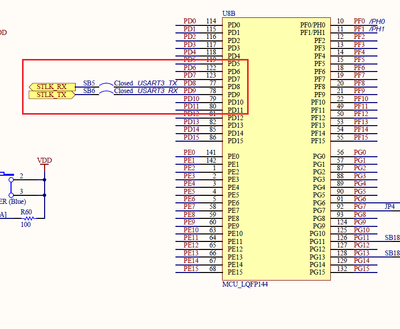

Hello @t-oka ,
First, before starting the printf usage over UART, you need to validate the UART transmission by for example just sending a couple of characters using HAL_UART_Transmit().
Second, you need always to check the schematics or board's user manual before suspecting an issue in the FW.
According to the schematics of MB1137 the UART instance connected to STLink-VCP on NUCLEO-F207ZG (MB1137) is USART3 and not USART2:
So you need to select USART3 instead of USART2
Refer to this printf example. on NUCLEO-F207
Hope it helps.

2024-09-23 7:15 PM
I was able to solve the problem with the help of your schematic and example.
Thanks.
