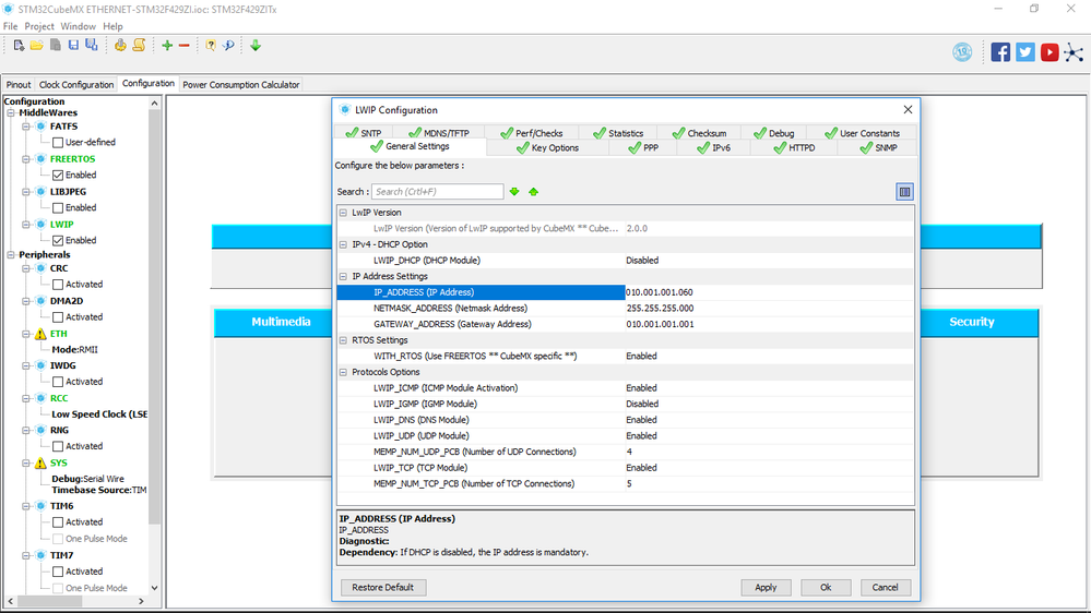

hi i declare this way
ip_addr_t local_ip;
ip_addr_t remote_ip;
then i fix it :
for local by cubemx if static
and for remote this way in my application :
IP4_ADDR(&remote_ip,10, 1, 1,89);
