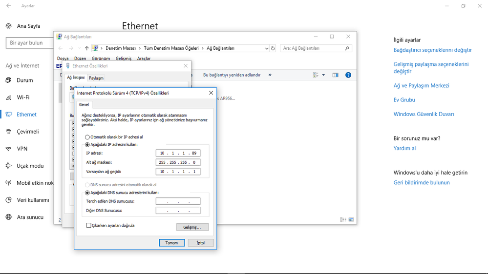

remote ip 10.1.1.89--->is my pc you can fix it if you want static by parameters .
you need to make gate way 10.1.1.1 and mask 255.255.255.0
on both pc and device this is my pc config it is my host for my application

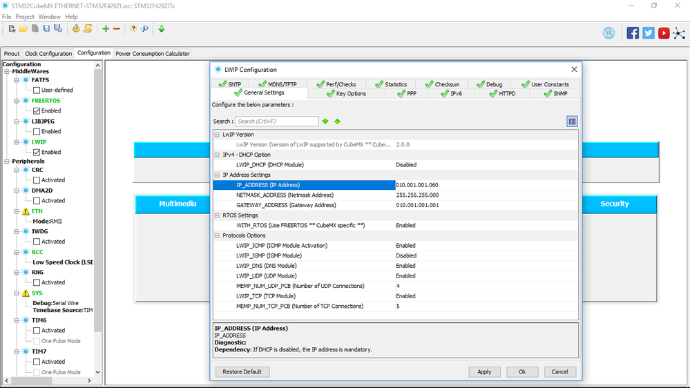

you can use this code for udp , in cube you fix the ip as static 10.1.1.60 of our stm
then you use this code :dot for get receive and sending port should be different as i understood ,and not used by another application :

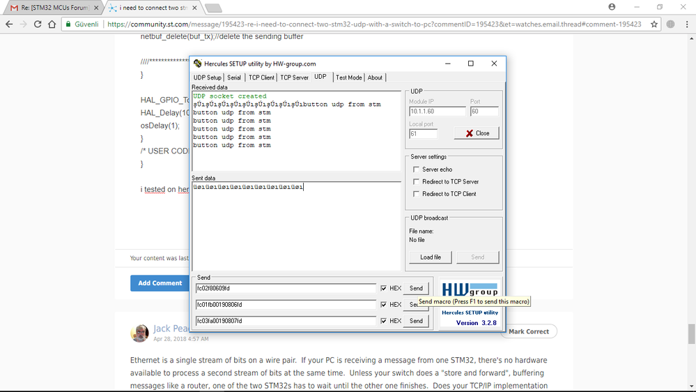

if(HAL_GPIO_ReadPin(GPIOC, BUTTON_Pin)==1)//USER BUTTON PUSHED send a text udp to the host { while(HAL_GPIO_ReadPin(GPIOC, BUTTON_Pin)==1)//////***********************send udp data to ethernet**********************************// sprintf(buffer,''button udp from stm\n\r''); struct netbuf* buf_tx = netbuf_new(); netbuf_ref(buf_tx,buffer, sizeof(buffer)); netconn_send(conn, buf_tx); netbuf_delete(buf_tx);//delete the sending buffer////********************************************************************************// } HAL_GPIO_TogglePin(GPIOB, GPIO_PIN_14);//blink a led on the cartHAL_Delay(100); osDelay(1); } /* USER CODE END StartCommunication_Task */}i tested on hercules udp :
good luck hope it will work for you
