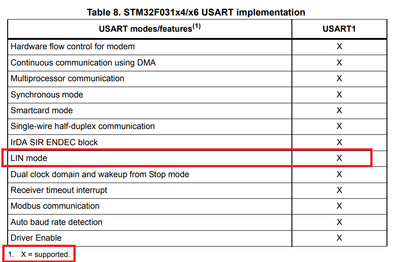

It depends on how to plan to use the MCU in your application and USART in STM32 features LIN mode.
For example, you can select STM32F031 MCU an entry level product that has one SUART instance (USART1) that features LIN mode. According to STM32F031 datasheet:
And yes you need a transceiver for LIN communication.

2024-07-19 6:55 AM - edited 2024-07-24 12:41 AM
