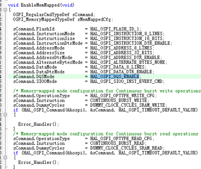

Thanks for your help, I have opened the DQS mode, but I have encountered a problem, as shown in the figure, the first two bytes (or some two bytes) cannot be written normally, I think it is because my psram chip is not set to DQS mode, but now my register can only be read but not written. But my register writing code was strictly in accordance with the psram manual, and it was the inability to write to the register that now caused me to accidentally get a two-byte error in memory mapped mode.So basically my question now is, why is my register write code not writing successfully.
DQS mode is opened:

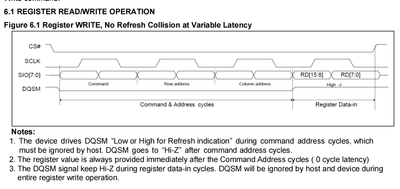

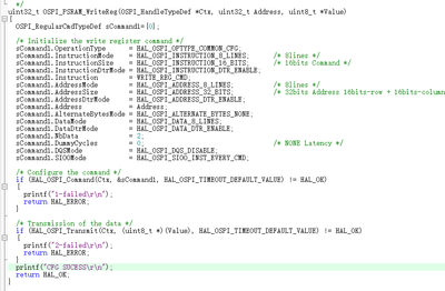

write rigister code and The timing chart in the manual:

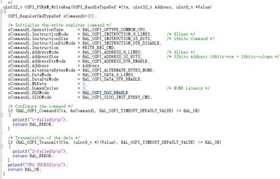

The above diagram has an error, using this code, but it still cannot be written properly.
write rigister code:
