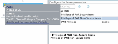

2024-01-23 5:12 AM
Double check the settings for PWR Mode in the MX configurator (the IOC file).
