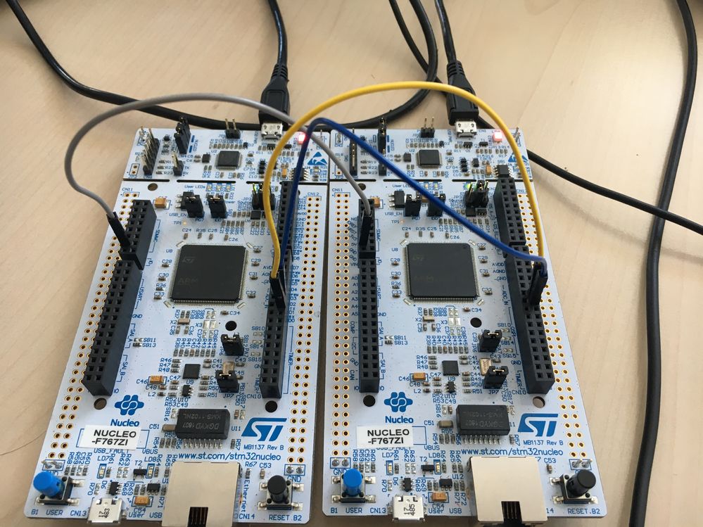

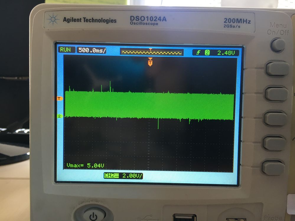

I'm using an oscilloscope and LEDs to test my code and functions.
GND pins are connected too.

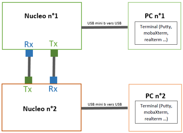

TO begin, i only transmit from one card to the other one with the function hal_uart_transmit as shown as below :

Have a common ground lead. While I suspect the USB might get you that, I'd prefer to see a board level bonding.

I added a ground cable between the nucleos (the result is the same).
It's weird because when i compile and debug on STM32CubeIDE this main.c on one nucleo, i should see" Hello World !!! "on command shell console.....
