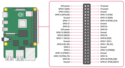

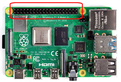

This one:
Check out the Raspberry Pi documentation to see what signals are available on that connector:
https://www.raspberrypi.com/documentation/computers/raspberry-pi.html#gpio-and-the-40-pin-header
You can clearly see that UART (TXD, RXD), SPI (MOSI, MISO, SCLK), and I2C (SDA, SCL) are all available on that connector, and documented on that page:
https://www.raspberrypi.com/documentation/computers/raspberry-pi.html#alternative-functions
and 3rd-party sites; eg,
https://learn.sparkfun.com/tutorials/raspberry-pi-spi-and-i2c-tutorial/all
