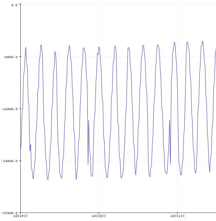

Considering the fact that I can no longer make a difference between waveforms sent at 1kHz (sin and triangular) I am wondering about what I did code wrong in my ADC initialization to mess up my results that much. Below is a 1kHz sin I get for my 200 kHz sampling rate (code below). I use an external Vref MAX6225ACPA to stabilize my reference.

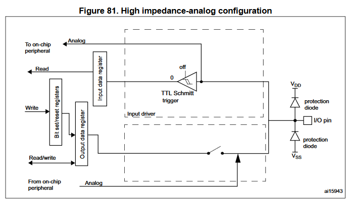

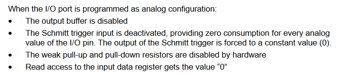

About using pull-up/down to test the signal I might be misunderstanding but am I not supposed to setup my pin as analog? In the datasheet, it is written that pull-up and down are turned off when the pin is used this way.

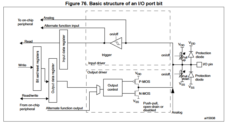

What's the risk? Writing the post takes more time than just try in debug mode manually playing with pupd registers (at least for me)
BTW, The capture doesn't locate the resistors.

It s not about whether I am willing to take a risk or not, I just can not make tests until Monday. So if asking that question may evidence a misconception I have on Analog pins I will ask it. The reason I started this post is to find where I messed up and from my experience, it always comes from a lack of knowledge so please allow me to try and understand the debug method advised here.
As for where the resistors are located the typical schematics for a GPIO pin are below as well as the line I consider to be specifying that there is no access to pull-up and down resistor in analog mode:

1) For my signal shape it was due to the way I read it, the serial buffer was overwritting values due to the serial communication being too slow for my sampling rate. I only plot two values for 10 samples now.
