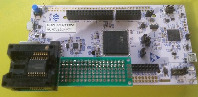

2024-10-20 8:59 AM
So perhaps clock phase or edges? Especially as the data desync's as you proceed.
This is a MT25 not a older N25 ?
I linked for thread context, mainly to confirm what you wired. I didn't find a circuit diagram, assuming pull-ups on the signals.
I tend to use ZIF fixtures so I can test different parts readily.

Do you happen to have the part number for the ZIF socket shown in the picture?
2024-10-20 10:26 AM
Pretty generic SOIC16W to DIP16, 1.27-mm pitch, 300-mill / 7.5-mm width
Sourced mine via eBay / AliExpress, perhaps $3-4
Not sure I have a part# SOP16-1.27TP ?
